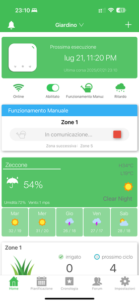

Hi everyone,
I'm experiencing a serious issue with my Netro Spark 8 controller. It connects correctly to Wi-Fi and appears online in the app, but when I try to start irrigation manually, the app just stays on "in communication" and nothing happens.
Here’s what I’ve already tried:
- Restarting both the app and the device
- Using a different Wi-Fi network, including a mobile hotspot
Despite these attempts, the problem persists. I also tested the solenoids with a multimeter, and they’re working correctly. If I activate the valves directly from the controller, they respond as expected—so it’s clearly not a hardware issue.
I should also mention that I previously had the same problem with two Sprite6 controllers. That’s why I switched to the Spark 8, hoping it would solve the issue. Unfortunately, it hasn’t.
To make matters worse, scheduled programs aren’t working either.
This is an urgent situation because my plants are currently without water. I’d really appreciate any help or suggestions to resolve this.
Thanks in advance,
Stefano

Spark not working – won’t start valves despite all attempts
Stefano
更新時間 2025-07-23 06:55:23 UTC
Hi everyone,
I’ve been using a Netro Spark (8-zone model) for some time, but recently it stopped working properly.
The controller connects to Wi-Fi and appears online in the app, but when I try to start any valve (manually or via schedule), it says “communicating” and nothing happens.
  • Restarted the Spark multiple times
  • Performed a full reset (12 seconds on RST button)
  • Re-added the device in the app
  • Tried to trigger irrigation manually from both the app and the controller
  • Confirmed that the system works when I open the valves manually from the controller
  • Tried different power supplies
  • Connected to a mobile hotspot instead of my home Wi-Fi (same result)
  • Updated the firmware to the latest version (v3.3.0)
  • Purchased a brand new Spark controller and tested it — same exact issue
At this point, it looks like the issue is not hardware or network-related.
Could it be a firmware bug or a server-side problem?
Any help would be greatly appreciated!
Thanks in advance,
Stefano Mauri
