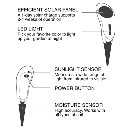

Getting to Know Your Whisperer

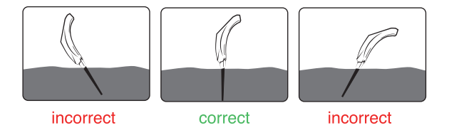

Prepare to Plant Your Whisperer
1. If you find it hard to insert the sensor into the soil, do not force it. You can try to use some water to soften the soil.
2. Make sure your Whisperer is not affected by other equipment or objects.
Insert the Sensor into the Soil
3. Push the sensor into the soil.
Adjust the height
Adjust the angle
