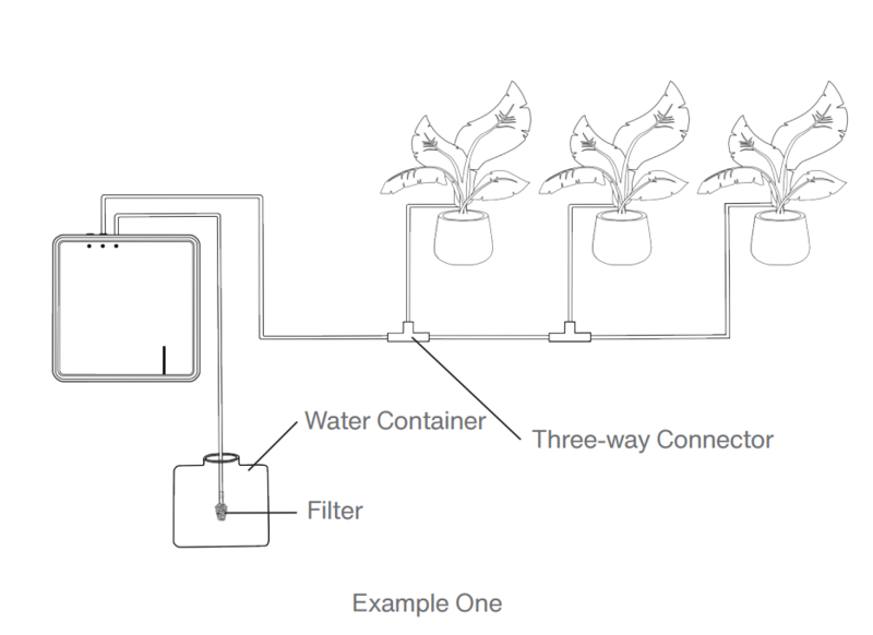

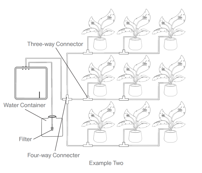

1. Please connect the pump to the tubing, and you can realize multiple-pot irrigation through multi-way connectors according to your personal needs. You can close unnecessary outlets with plastic plugs, and please use a filter at the water inlet to filter impurities in the water.
Tips: it is recommended to choose a small opening water container to prevent garbage and dust from falling out.
Here are two common irrigation connection methods (Water Outlet 1 is taken as an example), and you can combine it according to your actual needs.

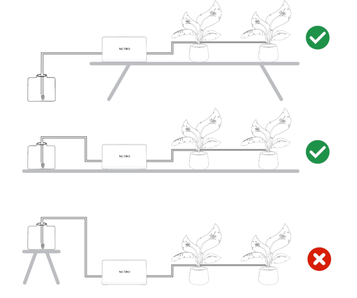

To prevent siphoning, if possible, place the water container below the potted plants. If not feasible, ensure the water container is at the same level as the potted plants.

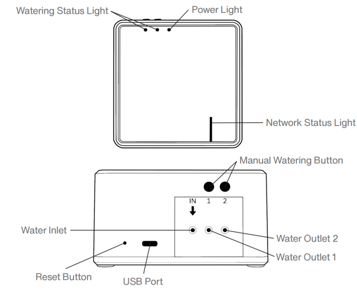

Watering Status Light
Stream's Watering Status Light has 2 possible statuses:
Solid blue: the pump is watering.
Flashes in blue (flashes once every 0.5 seconds): the pump is idling, please check if there is a lack of water.
Power Light
Stream's Power Light has 3 possible statuses:
Solid red: the pump is charging.
Flashes in red (flashes once every 15 seconds): the battery power is low.
Go out: when charging is completed, the red light will go out.
Network Status Light
Stream's Network Status Light has 7 possible statuses:
Solid white: this means the pump is trying to connect to your home WiFi. It will change into solid green or solid red within 30 seconds.
Solid green: the pump has connected to the network.
Flashes in green (flashes once every 0.5 seconds): this means the pump have been communicated with the cloud server.
Red (remain solid for 10 seconds): the pump fails to connect to the network, and it will enter Bluetooth Pairing Mode after 10 seconds.
Flashes in blue (flashes once every 0.5 seconds): the pump is in a Bluetooth Pairing Mode.
Solid blue: the pump has been connected via Bluetooth.
Yellow: the pump has been restored to factory settings.
Manual Watering Button
Stream's Manual Watering Button has 2 executable operations:Start-stop of manual watering : pressing the Manual Watering Button twice quickly when the pump is powered on, the pump will start watering. The default watering time is 1 minute , and if you want to stop watering earlier, please press the Manual Watering Button twice quickly again.
Wake up the pump: when the pump is in a sleeping mode, press the Manual Watering Button shortly (less than 1 second) will wake up the pump.
Reset Button
Stream's reset button has 4 executable operations:
Restart: when plugged in the power, press the reset button shortly (less than 1 second) will restart the pump. The pump will try reconnecting the Internet in the power-on state.
Power-on: press the reset button shortly (less than 1 second) in the power-off state will power on the pump. When powered on, the pump will try to reconnect the Internet.
Power-off: when the pump is in the power-on state and not plugged in, press the reset button shortly (less than 1 second) will power off the pump.When powered off, the pump is unavailable.
Restore factory settings/reconfigure WiFi: press and hold the reset button for 6 seconds in the power-on state, the Network Status Light will turn yellow, and the pump will restore factory settings and enter Bluetooth Pairing Mode. If you need to initialize all settings of the pump in the Netro app, please remove the pump from the app before performing operations above.
