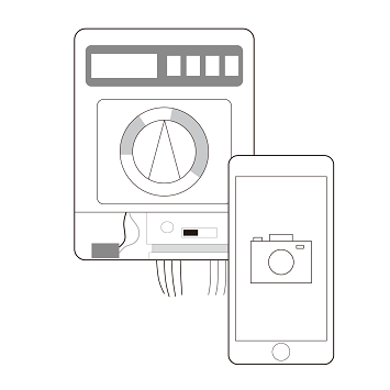

2. Unplug the power of your current controller.
3. Take a photo of the wiring in your old controller. When you are wiring Sprite, this photo can be the reference.
4. Remove your current controller.

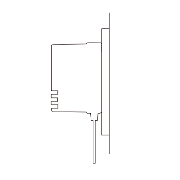

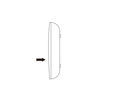

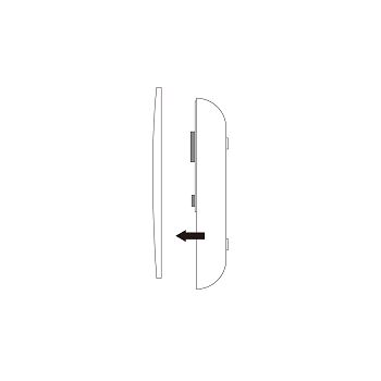

2. Remove the front cover from the base.

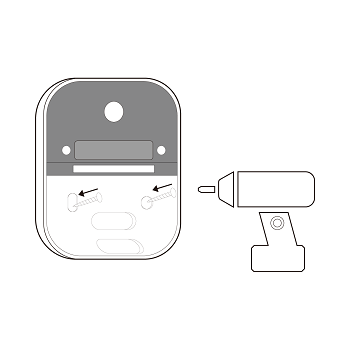

3. Install the Sprite base to the wall using the two screws included. Use the air bubble to position horizontally.

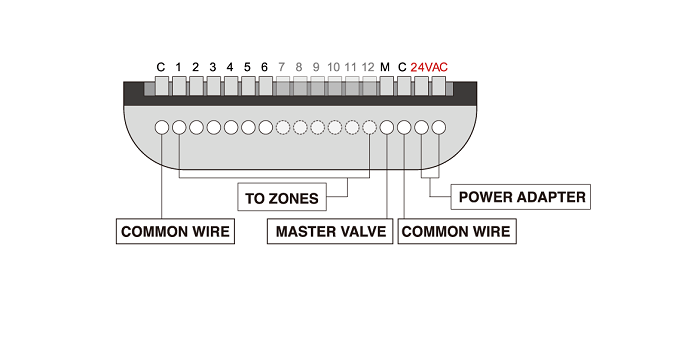

Wiring
4. Reconnect the wires to the terminals on the base.
Tips:
   1. Use the picture of the wires on your old controller to help you remember.
   2. The slot named “M” is for the master valve or the pump. In some controllers it is named as “PMV” or “P/MV”. If you do not have a master valve or a pump, you can leave this "M" slot unconnected.
   3. If the old controller has only one common wire, you can connect it to either one of the “C” slots and the other “C” slot will sit empty.
   4. If you want to use your old power adaptor which has a ground wire, you can leave the ground wire open.
   5. If the old controller is connected to a rain sensor, you do not need to connect the sensor wires because your Sprite obtains weather information from the WiFi network.
If you are not sure about the wiring, please send the picture of the wiring in the old controller to support@netrohome.com. Our customer service will provide quick support.

5. Put the front cover back on the base.

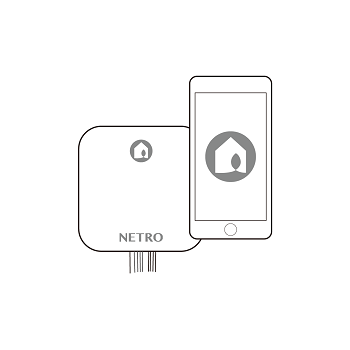

8. Download the free Netro app and start to configure.
Tip:
Search for "Netro sprite watering" on Google Play and App Store.
