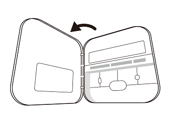

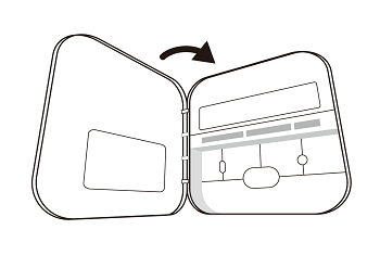

2. Remove the front cover from the base.

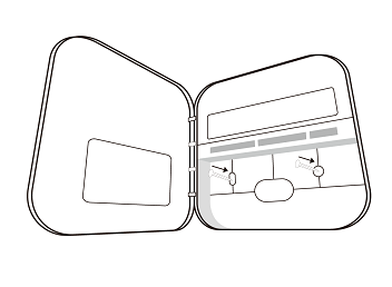

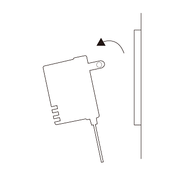

3. Install the Spark base to the wall using the two screws included.

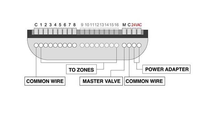

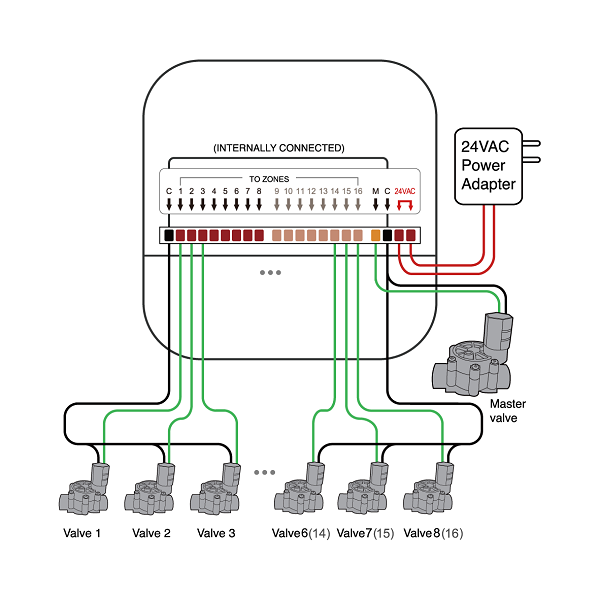

4. Reconnect the wires to the slots.
Tips:

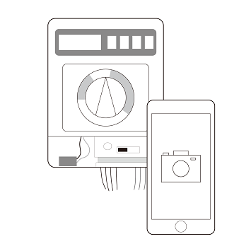

1. Use the picture of the wires on your old controller to help you remember.
2. The slot named “M” is for the master valve or the pump. In some controllers it is named as “PMV” or “P/MV”. If you do not have a master valve or a pump, you can leave this "M" slot unconnected.
3. If the old controller has only one common wire, you can connect it to either one of the “C” slots and the other “C” slot will sit empty.
4. If you want to use your old power adaptor which has a ground wire, you can leave the ground wire open.
5. If the old controller is connected to a rain sensor, you do not need to connect the sensor wires because your Spark obtains weather information from the WiFi network.
If you are not sure about the wiring, please send the picture of the wiring in the old controller to support@netrohome.com. Our customer service will provide quick support.

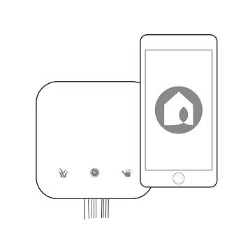

6. Plug in the power. Wait for 10 seconds, the light will be blinking slowly.
7. Download the free Netro app and start to configure.

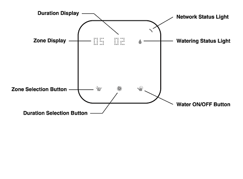

Network Status Light
The network status light on your Spark has five possible statuses:
Blinking slowly in blue: this means the controller is in its HOST mode. This happens when you first plug in your Spark or reset it, and indicates that it needs to go through the setup steps in the app to connect to a home WiFi network.
Solid in white: this means the controller is trying to connect to your home WiFi. It will change to either solid green or solid red within 30 seconds.
Solid in green: this means the controller is connected to your home WiFi.
Blinking in green: this means the controller is communicating with the cloud server.
Solid in red: this happens when you first set up your controller and did not enter the correct password, or whenever it loses its connection to the Netro cloud server.

Manually Control from the Console
You can manually start or stop watering by using the three buttons on the console.
Start a manual run:
1. Press the Zone Selection Button(left button) to select a zone. To select all the zones, hold the button until the Zone Display shows “_ _”.
2. Press the Duration Selection Button(middle button) to select the duration in minutes. Holding the button will accelerate the increment of minutes.
3. Press the Water ON/OFF Button(right button) to start the watering.
